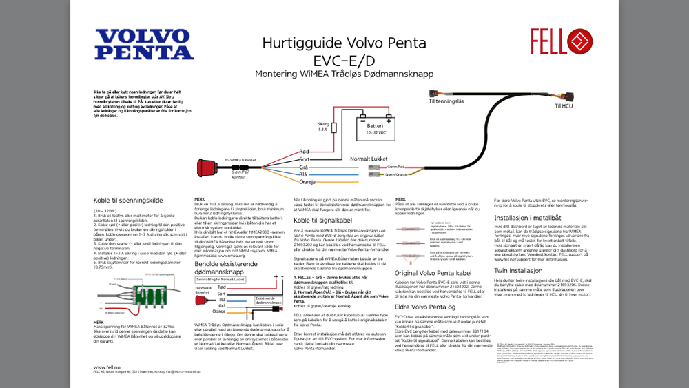

Eg har installert denne dødmannsknappen på min båt. Aldri brukt dødmannsknappen som var der da den er ubrukelig med en gang man skal gjøre de tingene som er risikofylt.
Er KANON fornøyd. Funker prikkfritt. (Hatt den kort tid, men er jo flere her inne som har hatt de i flere år)
Anbefales.
De andre spm må andre svare på. F.eks fell selv:
No. WiMEA® Protocol is a unique wireless protocol, comparable with Bluetooth 2,4 GHz protocol or the WiFi protocol in wireless routers in your home. WiMEA® Protocol complies with strict requirements for separation of wireless signals. This is tested and certified to comply with the R&TTE directive for this kind of product at Nemko in Norway as required by CE and IEC60945 certification in the EU, and by FCC in US and Canada. In the unlikely event that you experience interference on other systems we suggest you consult the respective systems producer to be sure it complies with the R&TTE directive and has the necessary certifications. Do not hesitate to contact FELL directly if you experience interference on other systems close to your MOB+ system. Please see the user manual for details regarding WiMEA® Protocol.
