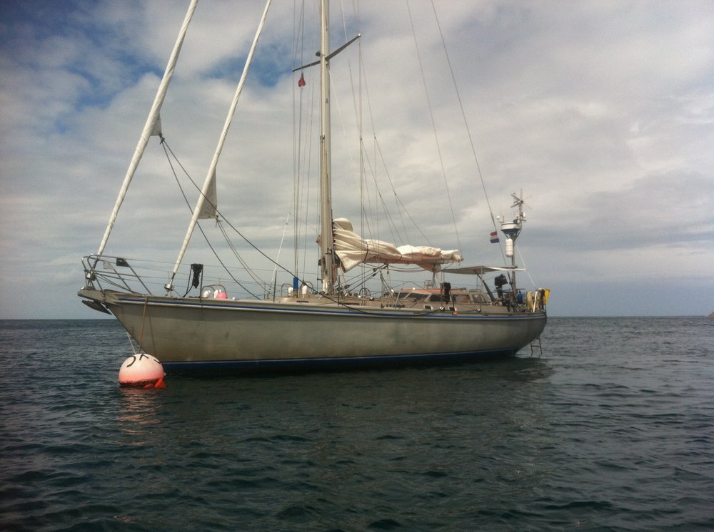

Hello. I plan to stay in Tromsø during the winter of 2018/2019, with my aluminium 44 ft Koopmans sailing ship. I live permanently on this boat. It has an insulated hull and top, but it is not optimised for artic circumstances. For instance, windows are a single layer of hardened glass or polycarbonate. The metal window frames form a cold bridge, which is liable to condensation or frosting from inside.
I plan to add a boatcover, supported by the boom, which will act as an 'umbrella' above the deck, to reduce heat radiation. When the temperatures are such that collected snow will be permanent, I will take the boatcover away, so the deck can be covered with an insulating snow cover.
My question: When I visited Oslo in winter, I saw that some boats in harbour had a kind of 'blankets', apparantly for insulation purposes. Are these standard products which I might find around Tromsø?
