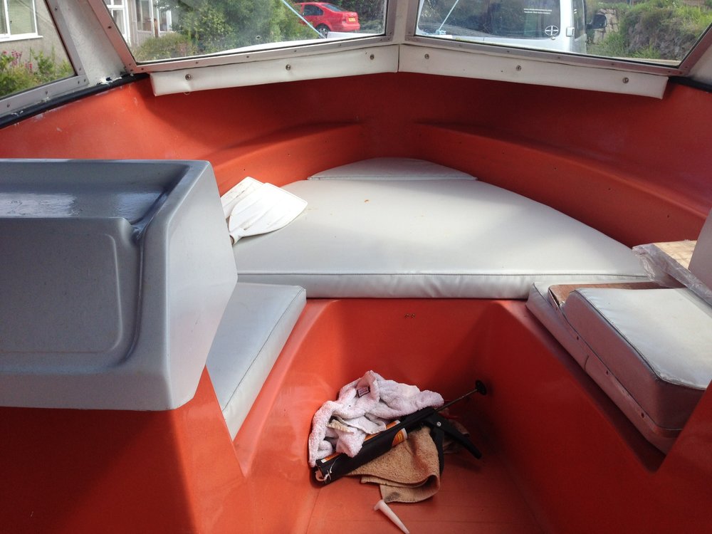

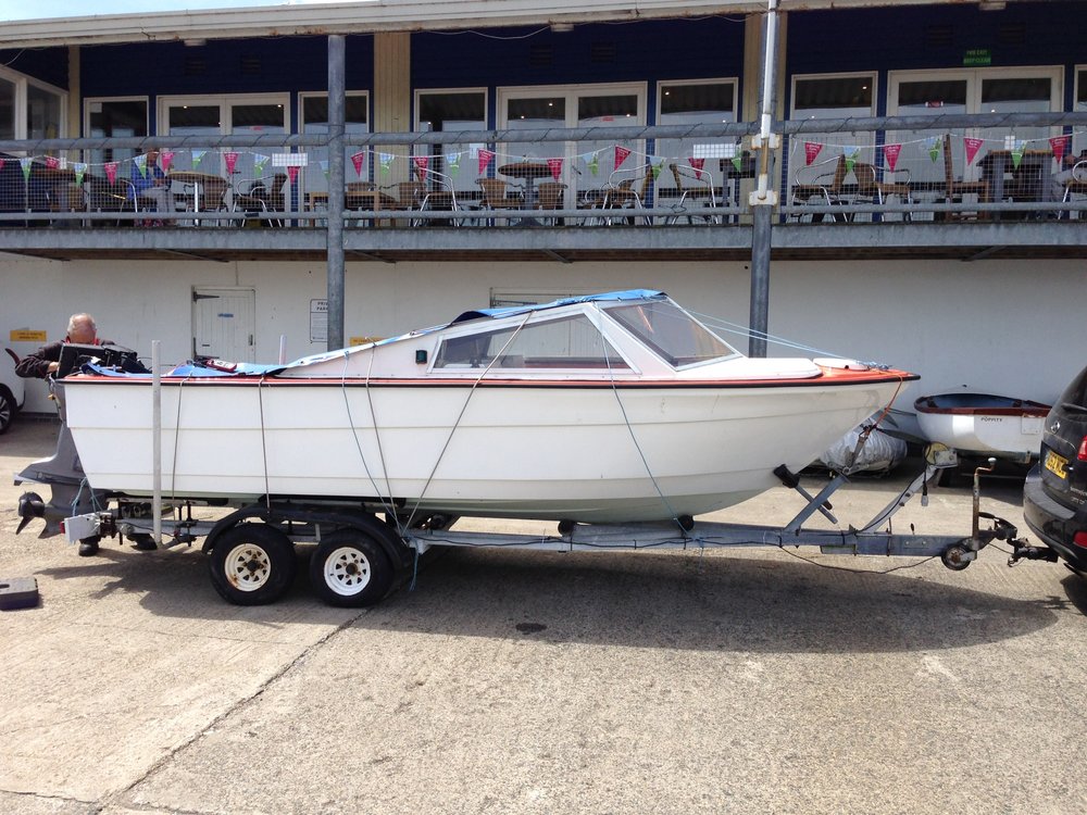

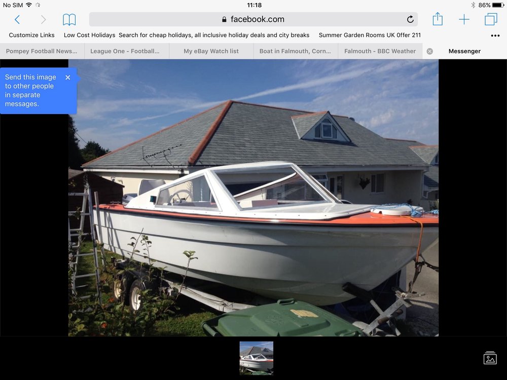

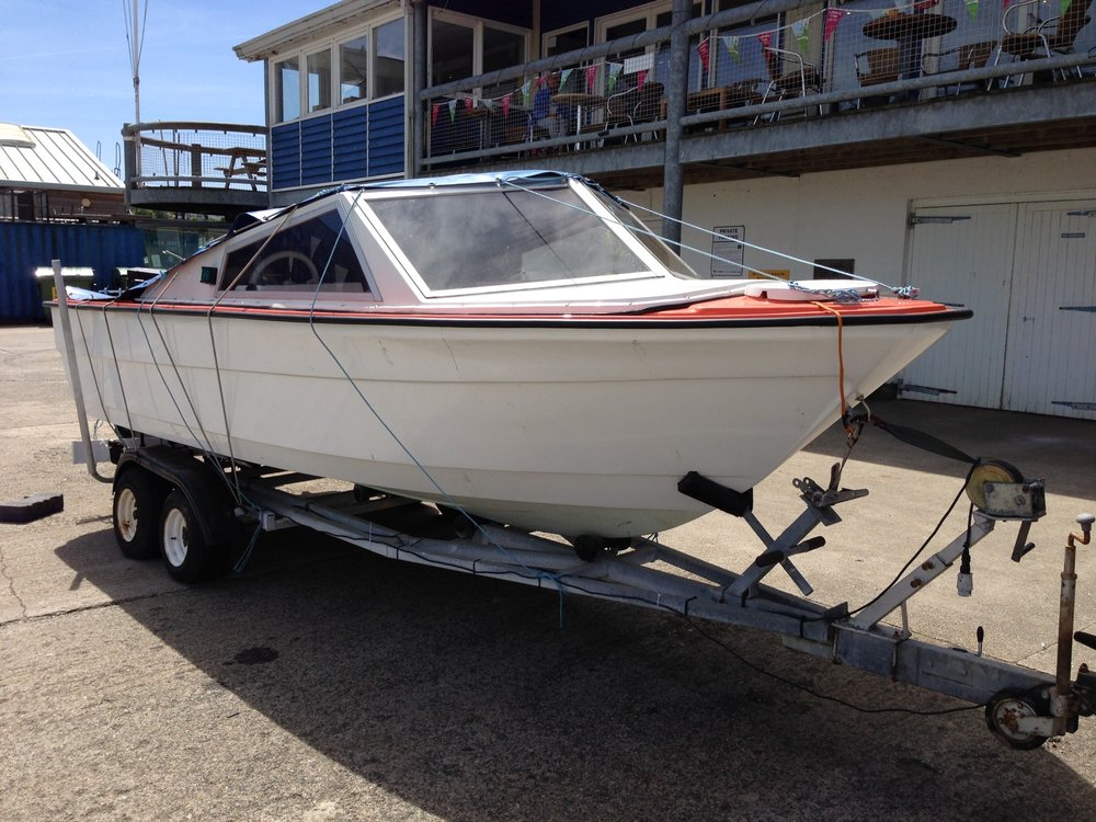

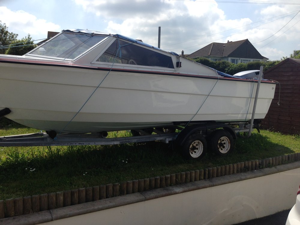

Craig Morebas 17 Startet 5.Juli.2018 Link til dette innlegget Startet 5.Juli.2018 Hi guys, my name is Craig and I recently brought a Morebas 17 to use around the coastal waters of Falmouth Cornwall England, it's been a great boats in the little time I've had it,the Engine it has is a 2000 model Johnson 90hp 2storke, i'm just after some more information on the boat, The specification , is the engine already have too big for it or couldn't go bigger etc? With thanks Craig. Sorry if this is posted in the wrong forum thanks again?? Sitér dette innlegget Link to post
