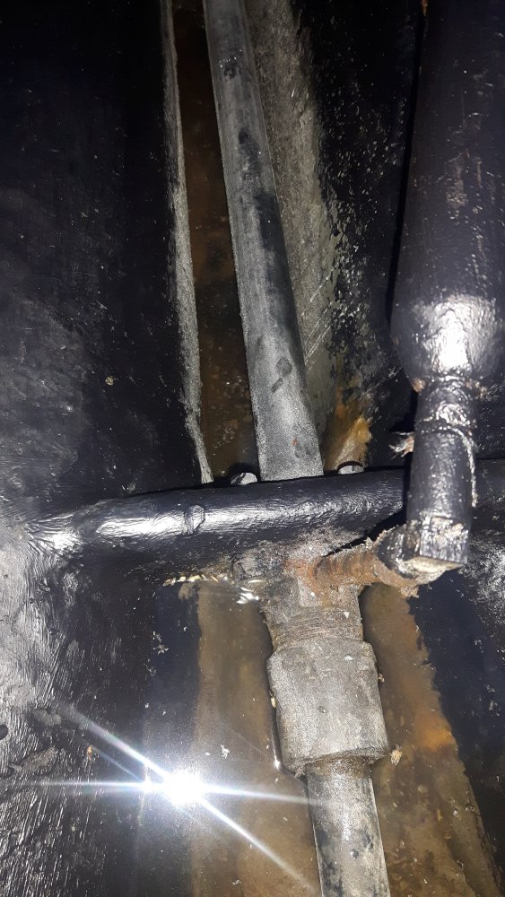

Stoyan Staykov Startet 28.Juli.2019 Link til dette innlegget Startet 28.Juli.2019 Hello, I have Fram 21 Snekke. There are 3 sections on floor of the boat where water gathers because of rain if it stays open. My question is does these 3 sections must be connected? Here's the issue that I have: I pump out one of the sections and the other two stay filled. What to do? I'm sorry, probably to some of you is obvious, but this is my first boat andI don't have idea how it works. Sitér dette innlegget Link to post
Stoyan Staykov Svart 28.Juli.2019 Emnestarter Link til dette innlegget Svart 28.Juli.2019 Here is some pictures, maybe will make it easier to understand my issue. Thanks in advance for your time ? Sitér dette innlegget Link to post
Hakkannen Svart 28.Juli.2019 Link til dette innlegget Svart 28.Juli.2019 There should be some small holes between the sections, these sections should be connected. Put your hand down in the water en try to feel if there is these holes, maybe they are filled with some dirt or something? Sitér dette innlegget Link to post
