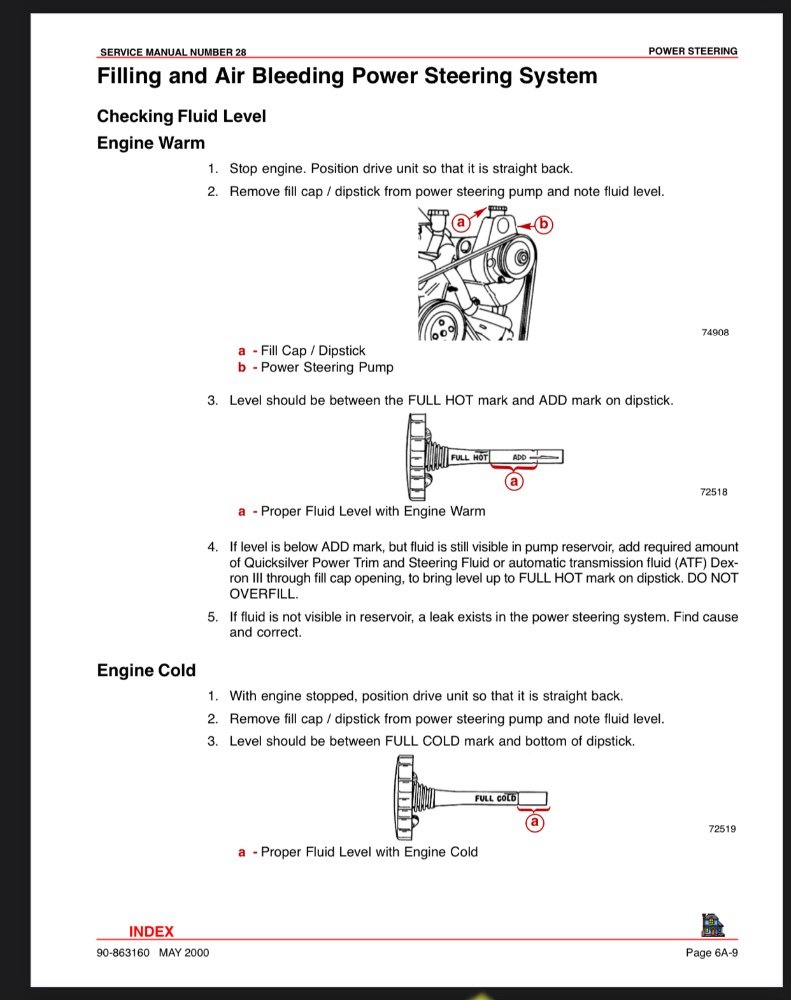

Spannerman Svart 6.Juni.2022 Link til dette innlegget Svart 6.Juni.2022 1 cm is ok on the steering cylinder. The oil should be about3-4 cm from the top of the reservoir. Just a question, you haven’t changed to different type of prop? Its strange that this has only started after the service if everything is the same as before. What you are describing is definitely torque steer as I have experienced this on several boats I’ve worked on, and can vary with speed and trim angle. Normally hydraulic steering stops this feed back or fitting a trimtab fin on the cavitation plate, but you have never had one so it must be something has changed in the steering system. Sitér dette innlegget Link to post
Ibiza 8.1L V8 Svart 6.Juni.2022 Emnestarter Link til dette innlegget Svart 6.Juni.2022 (redigert) Ok, same prop also. Reservoir had oil but only 1-2cm. I totally agree with the torque steer, only the compensation from the servo isn’t there anymore. the workshop had the whole engine out and the out drive, so many they did something to the servo when installing the engine back in? by the way, there was a little bit pressure opening the servo cap, could it be air in the system from disconnecting engine? Redigert 6.Juni.2022 av Ibiza 8.1L V8 (see edit history) Sitér dette innlegget Link to post

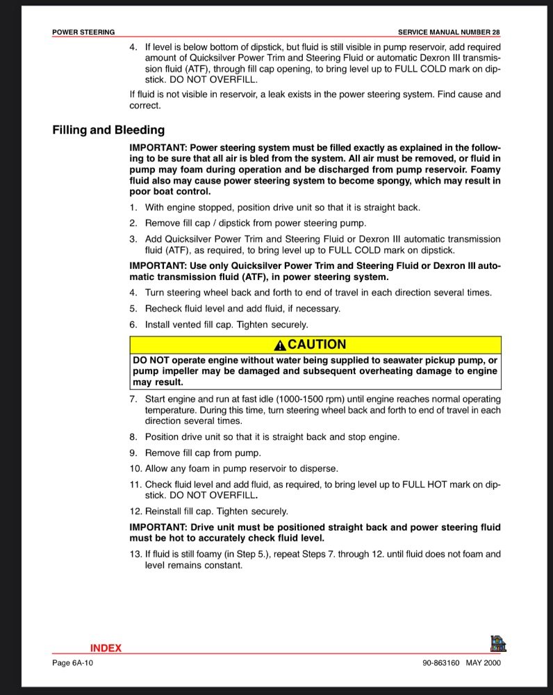

Fantino Svart 6.Juni.2022 Link til dette innlegget Svart 6.Juni.2022 Venting procedure is probably worth trying? Full downloadable manual here (if it covers correct model): https://d3gqux9sl0z33u.cloudfront.net/AA/AR/wetbristol/downloads/224963/Bravo_stern_drives.pdf Sitér dette innlegget Link to post

Fantino Svart 7.Juni.2022 Link til dette innlegget Svart 7.Juni.2022 I wouldn’t be too surprised if too little venting is the problem. Have had the same 2 times after having mechanics on board. Sitér dette innlegget Link to post
