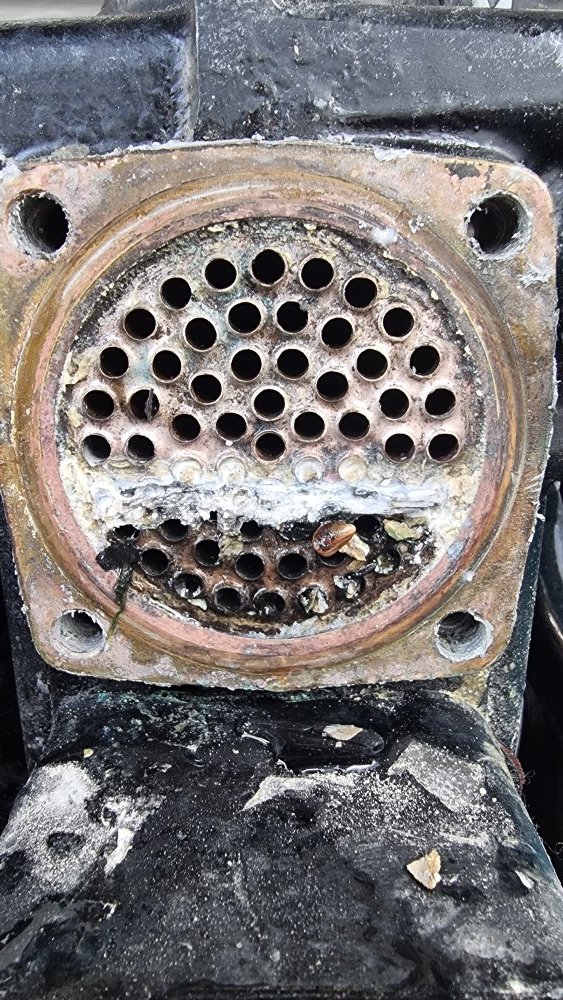

Theguy Svart 15.April.2023 Emnestarter Link til dette innlegget Svart 15.April.2023 Thanks Jens, I removed the cover and found this (image) Is there a water inlet on the drev I need to check too in case it's blocked? Sitér dette innlegget Link to post

Theguy Svart 15.April.2023 Emnestarter Link til dette innlegget Svart 15.April.2023 (redigert) I'm not sure if my other post git posted, so here it is again: The image shows how the heat exchanger looks, I'll clean it out with pipe cleaners, and then figure out the systemrens bit. Is there a water inlet on the drev that needs checking too to see if it's blocked? I saw both anodes, so I know what to remove. Do I just replace them with normal bolts while the systemrens does its thing? Redigert 15.April.2023 av Theguy Forgot a line (see edit history) Sitér dette innlegget Link to post

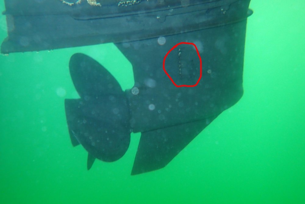

Jens_P Svart 15.April.2023 Link til dette innlegget Svart 15.April.2023 Theguy skrev for 5 timer siden: Is there a water inlet on the drev that needs checking too to see if it's blocked? Here: Then inlet in drive an the internal pipe that goes 10-15 cm upwards to the water pump. Use somthing in plastic so you don't damage the paint. I prefer a cable tie that is about 20cm long. When removing anodes, you kan use 1/2 inch blindplug from a plummer (or Jula or Biltema). Sitér dette innlegget Lykke er en kombinasjon av god helse og dårlig hukommelse! Link to post
