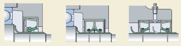

Roger jo Svart 15.Mai.2017 Link til dette innlegget Svart 15.Mai.2017 nei http://www.skf.com/us/products/seals/industrial-seals/power-transmission-seals/wear-sleeves/skf-speedi-sleeve/installing-skf-speedi-sleeve/index.html Installing SKF Speedi-Sleeve Although installation is simple, it should be done carefully to achieve the best results. As the thin-walled sleeve has an interference fit, any disturbances on the shaft surface may create a similar pattern on the sleeve surface and cause the seal to leak. Therefore, the seal counterface surface of the shaft should be carefully cleaned and any burrs or rough spots filed down prior to installation. Deep wear grooves, scratches or very rough surfaces should be treated with a suitable powdered metal epoxy-type filler. The sleeve must be positioned on the shaft before the filler has hardened. SKF Speedi-Sleeve must not be installed over keyways, cross holes, splines or threads since this will result in deformation of the sleeve, making it difficult for the seal to follow its new counterface surface as it rotates. SKF Speedi-Sleeve should never be heated prior to installation. Using heat will cause the sleeve to expand, but when it cools, it may not contract back to its original size, resulting in a loose fit on the shaft. SKF recommends different SKF Speedi-Sleeve installations (fig 1). Sitér dette innlegget Kokekyndig maskinist kjent på kysten. Link to post

fannefjord 2 Svart 15.Mai.2017 Link til dette innlegget Svart 15.Mai.2017 http://www.skf.com/binary/21-128020/11337_2-EN-SKF-Speedi-Sleeve.pdf Sitér dette innlegget Link to post
Trygve Lunheim Svart 18.Mai.2017 Link til dette innlegget Svart 18.Mai.2017 Det er vel bare å måle? Dimensjon på aksling er 1.25", eller 31.75mm nominelt. Speedi-sleeve art.nr 99125 skulle kunne gjøre jobben. beskrivelse her: http://www.sailguide.com/forum/viewtopic.php?t=10335 Sitér dette innlegget Link to post
