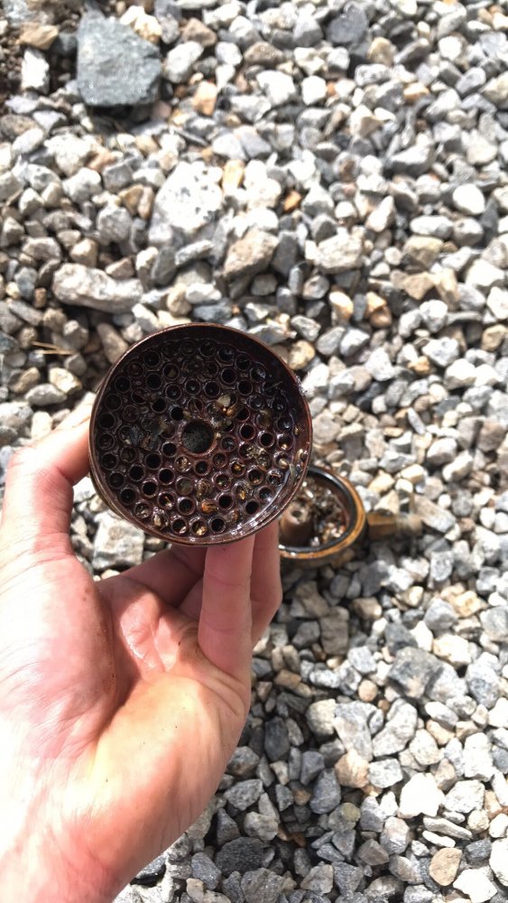

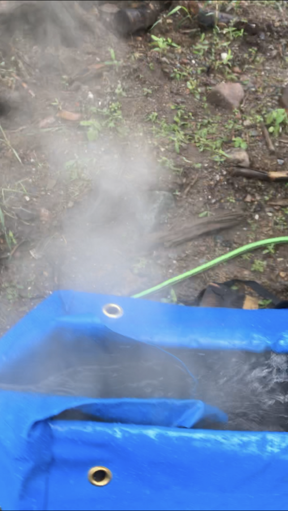

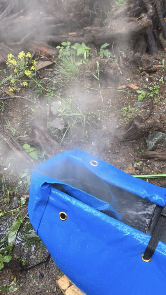

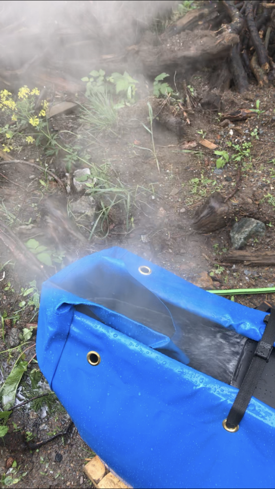

Anthony Startet 24.Mai.2019 Link til dette innlegget Startet 24.Mai.2019 Good evening i I have a problem with my Volvo aq140a it’s smoking white I’m not sure but it seems to be steam or to mush fuel . any one have tips are had the same problem . Thank you in advance . Sitér dette innlegget Link to post
Bestefar Svart 24.Mai.2019 Link til dette innlegget Svart 24.Mai.2019 Look like steam for me. Try to catch some of the steam and let it condense. Then it should be possible to check if ITS water or oil. If it is steam from water it is vise to check your engine oil. Is it "greyish" just after you have run the engine, it might be a leak in the cylinder head packing (I am not sure if "cylinder" head is the correct description for topplokk). If you can not run the engine, you can dras some oil from the absolut losset point of the sump. Good luck! Sitér dette innlegget Link to post

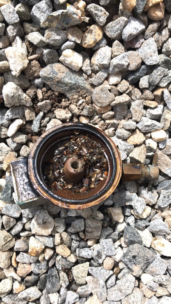

Anthony Svart 27.Mai.2019 Emnestarter Link til dette innlegget Svart 27.Mai.2019 Thank you for your help I’m not sure if I fixed or not but there no signs of water in the oil so I dismantled the cooling system until exhaust manifold and the oil cooler was stuck and the steam came from to little flow in the exhaust Sitér dette innlegget Link to post
Bestefar Svart 5.Juni.2019 Link til dette innlegget Svart 5.Juni.2019 Sounds and looks correct. By now you have probably put parts together and tested the engine and all works fine. Sitér dette innlegget Link to post
