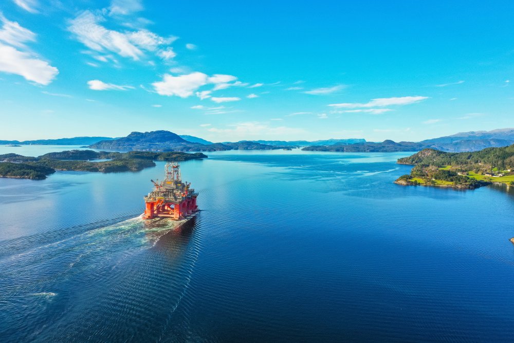

Arbeidsplassen min, MODU Transocean Spitsbergen, er den første boreriggen i verden med hybrid fremdriftssystem installert. Er dette noe som kan brukes i fritidsbåter? Mye fokus på ren batteridrift her i sommer, men for mitt eget vedkommende er det helt uaktuelt med så begrenset rekkevidde til min båtbruk.
STEINHAUSEN, Switzerland, Oct. 02, 2019 (GLOBE NEWSWIRE) -- Transocean Ltd. (NYSE: RIG) announced today that it has successfully deployed the world’s first hybrid energy storage system aboard a floating drilling unit.  The system is now operational on the Transocean Spitsbergen, engaged in drilling operations at the Snorre field in Norway.
Transocean’s patented1 hybrid power technology, developed in partnership with Aspin Kemp and Associates, reduces fuel consumption and increases a dynamically positioned rig’s station-keeping reliability by capturing energy generated during normal rig operations that would otherwise be wasted, and storing it in batteries.  This energy is then used to power the rig’s thrusters.  This important operational and safety enhancement targets a 14% reduction in fuel use during normal operations, leading to a significant reduction in NOx and CO2 emissions.
Transocean’s investment is funded in part through fuel saving incentives in its contract with Equinor and by the Norwegian NOx Fund.
“This first of its kind hybrid power upgrade will further enhance the reliability of our operations, while simultaneously reducing fuel consumption, operating costs and our environmental footprint,” said Jeremy Thigpen, President and CEO.  “We are pleased and proud to work alongside Equinor to jointly identify and implement more efficient and sustainable technology to deliver high-value wells to the industry.”
Utseiling fra Ølen. Skånevikfjorden:

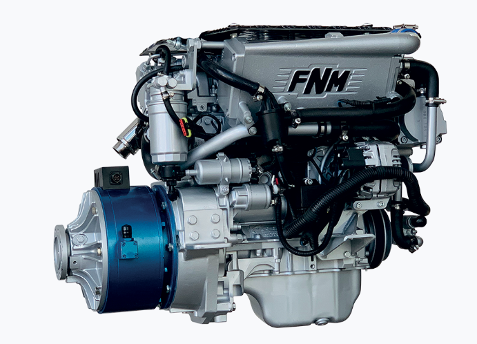

Trang ny motor for noen år siden. Det var en KAD44 som måtte gruses og det hadde jeg ikke tid til, uka før ferien. Dro i Volvobutikken for å kjøpe ny, men de kunne ikke levere det jeg ville ha. De ville rett og slett ikke hente en i sverige til meg... ble så sur at jeg så til Italia og hentet en FNM (nå kommer poenget) der sto det en 250hkj ferdig rigget som hybrid, hadde jeg ikke hatt alle transittpapirene klare så hadde jeg nok valgt den...
Har tenkt på det valget mange ganger :crazy:
I dag er jeg ikke i tvil. Hadde virkelig følt meg vel med en hybrid under dørken.
(bildet viser en motor i samme familie)
