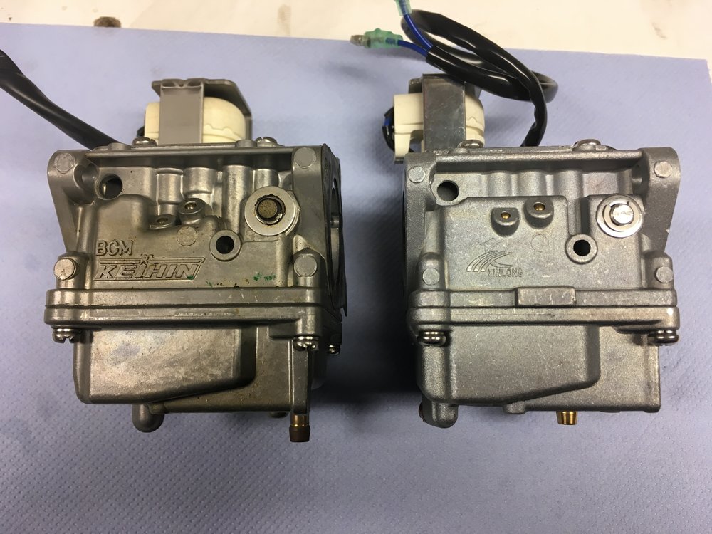

raunz Svart 31.Oktober.2017 Link til dette innlegget Svart 31.Oktober.2017 After reading this topic I ordered a replacement carburetor from China for my Yamaha F15CE outboard engine (carburetor model 6AG-14301, model year 2007, with remote control and electric start). The main differences between the F15 (6AG) and F20 (6AH) carburetors are the jets and air intake hole size. There is no point to change only the jet's. By the way, there are no additional parts needed to be changed (e.g. CDI or something) - only the carburetor. I haven't occured any starting problems also - I didn't change back the auto-prime unit with the old one from 15hp carb. Engine starts within a second every time. Flawless operation. I have a 4.6m plastic boat (dry weight with engine ~300kg) and with 2 men onboard earlier got approx 22..24km/h. After replacing to chinese carburetor I got 33..35km/h. Prop size 9.25x10 (3 blade). The engine full throttle RPM increased from previous 5200RPM to 6050RPM. Total cost: 75€ Look for "Outboard Engine Carburetor Assy 6AH-14301-00 6AH-14301-01 for Yamaha 4-stroke F20 Boat Motor" on Aliexpress SouthMarine Engine Parts Store. I attached some photos where on the left is original Yamaha F15 japanese Keihin carburetor, on the right chinese xinlong carburetor. Sitér dette innlegget Link to post
