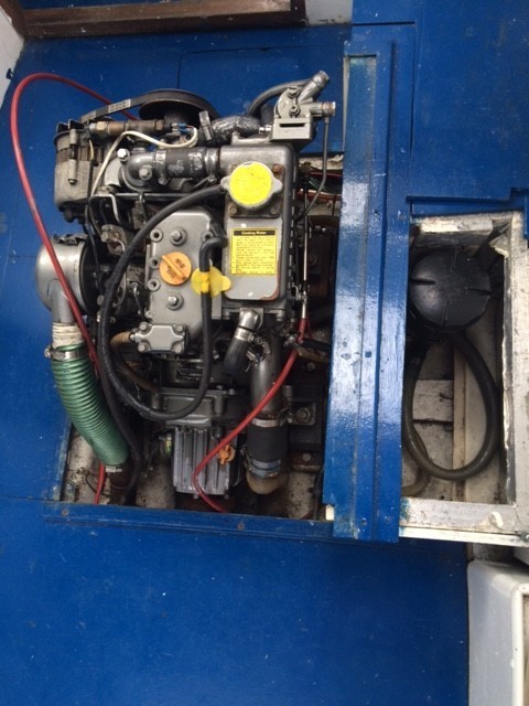

...do you perhaps have a picture of your motor in your boat ??
I have a Myra 21 too, but still has the original MD2B unit.
THANKS,
V.
