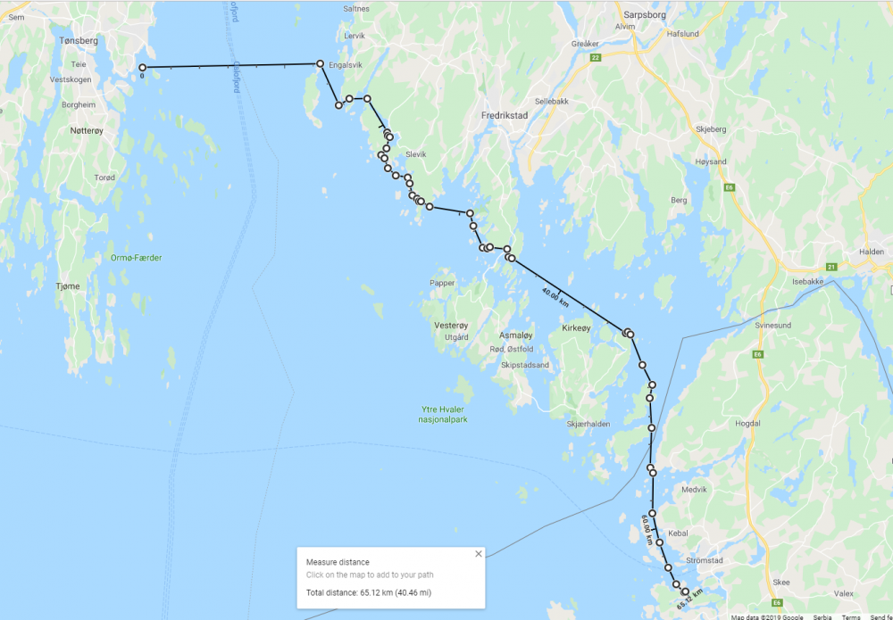

Expect approximately 40- 50 nautical miles pr. day, or 10 hours boating. So depending on where you plan to start:
Tønsberg - Fjällbacka (SE)
Fjällbacka - Rörö
Rörö - Varberg
Varberg - Torekov
Torekov - Malmö
Malmö - Stavreby (Dk)
Stavreby - Gedser
Gedser - Marina Großenbrode (DE)
Marina Großenbrode - Lubeck
Good weather is a must on some of the passages.
