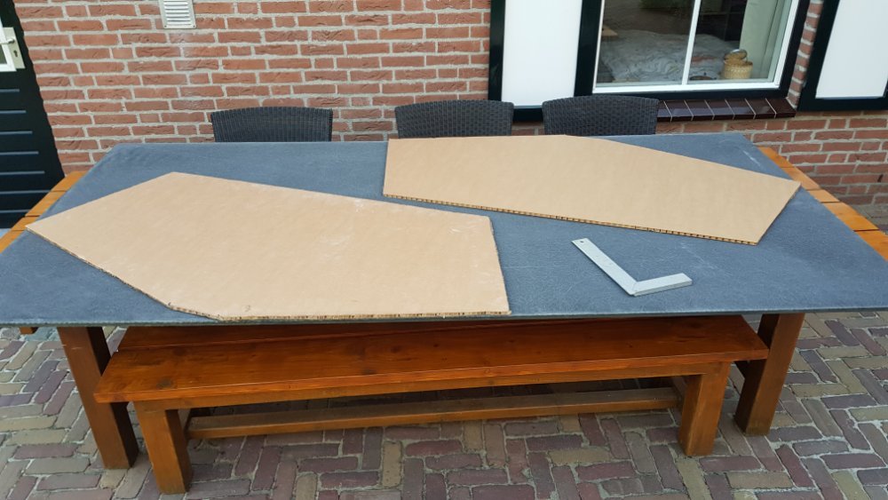

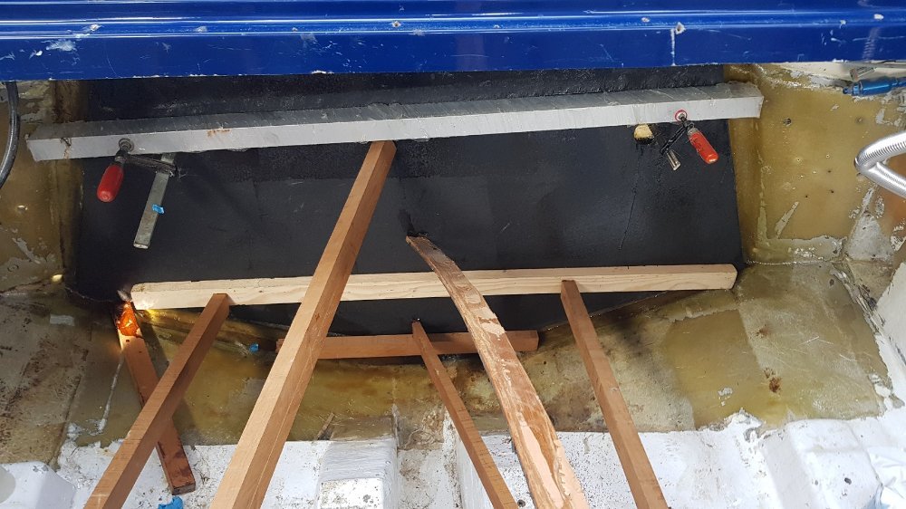

doctordre Svart 3.April.2025 Emnestarter Link til dette innlegget Svart 3.April.2025 Next step replac the wood. Instead of wood i will use coosa board. This is nothing more that a lot of layers of polyester. To get the thickness back I use three layers of 12 mm board. the total thickness was 44mm First made a cardboard template to figure out the best way to use the plate. For each coosa board layer it will be fixed by 2 layers of fiberglass and then the last layer as think as it needs to be. Else I would change de engine mounting positions Sitér dette innlegget Link to post

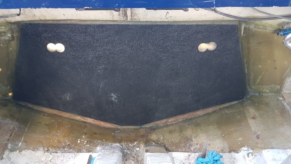

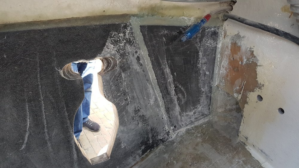

doctordre Svart 17.Juni.2025 Emnestarter Link til dette innlegget Svart 17.Juni.2025 replaced the wood by 3 layers. it is 45mm thick again. The holes for the helm extra wide Drive holes a little bit smaller than original. side panel extra reinforced where the new tab will be mounted After some sanding ready for a lick of paint Sitér dette innlegget Link to post
