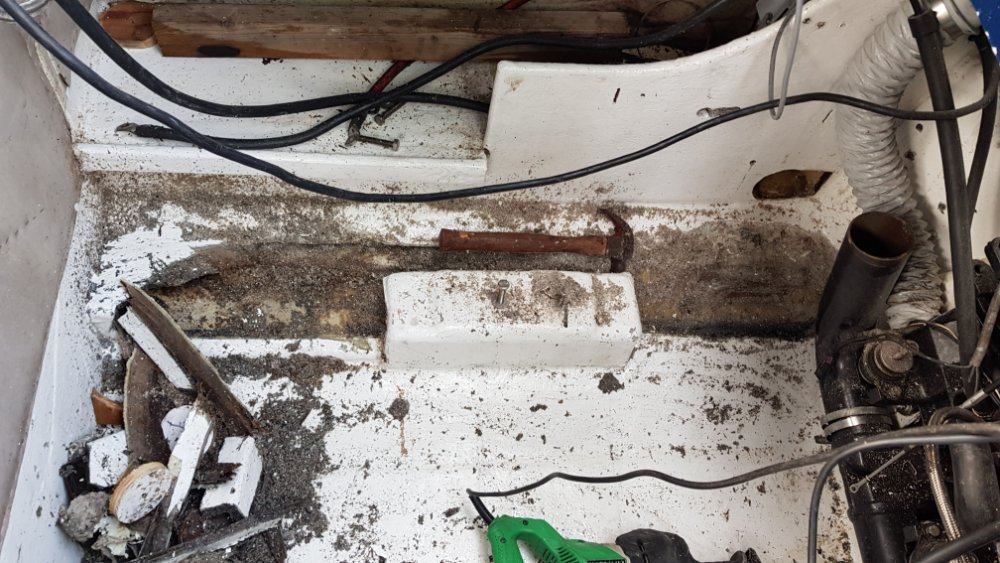

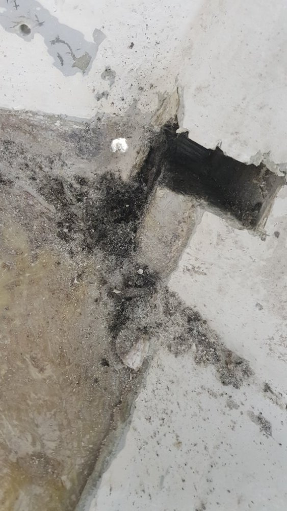

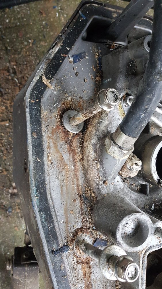

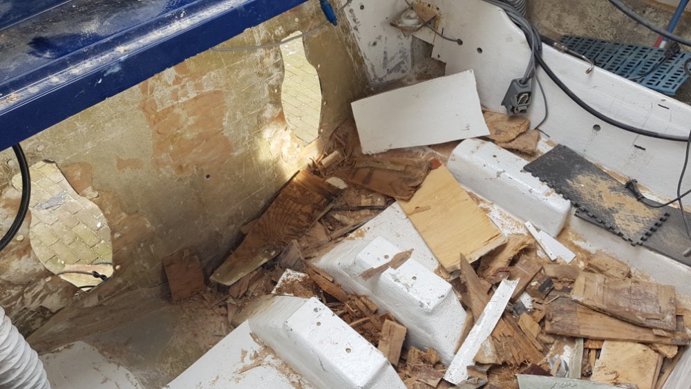

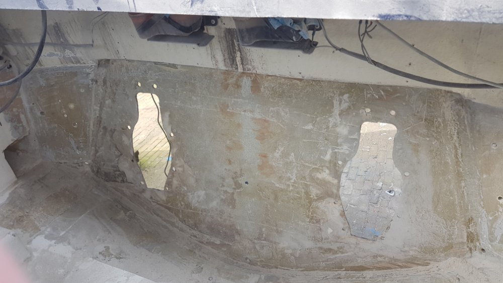

doctordre Svart 3.April.2025 Emnestarter Link til dette innlegget Svart 3.April.2025 Big Setback. Soft wood in the transom. While installing drilling holes for the new tabs, water came out. That is not a good sign. To find out where the problem is I made so probe holes in the floor bottom. Al lot of water came out. A piece of the flat floor remove and found that the wood was wet and soft . So i decide to remove the while floor side. After clearing and clean there was no crack or hole to the outside of the boat. But I found a little hole in the transom polyester connect with the floor. I removed a little piece of wood from the transom. Unfortunately it was black and soft. after removing a bigger piece it showed that the wood of the whole starboard side was wet. it still had strength. But it needs replacing the wood. Now everything is removed When removing the transom the cause became clear. see last photo. Water leaked along the thread of the drive into the transom plate and in between the plate and the drive. now continuing fixing Sitér dette innlegget Link to post
